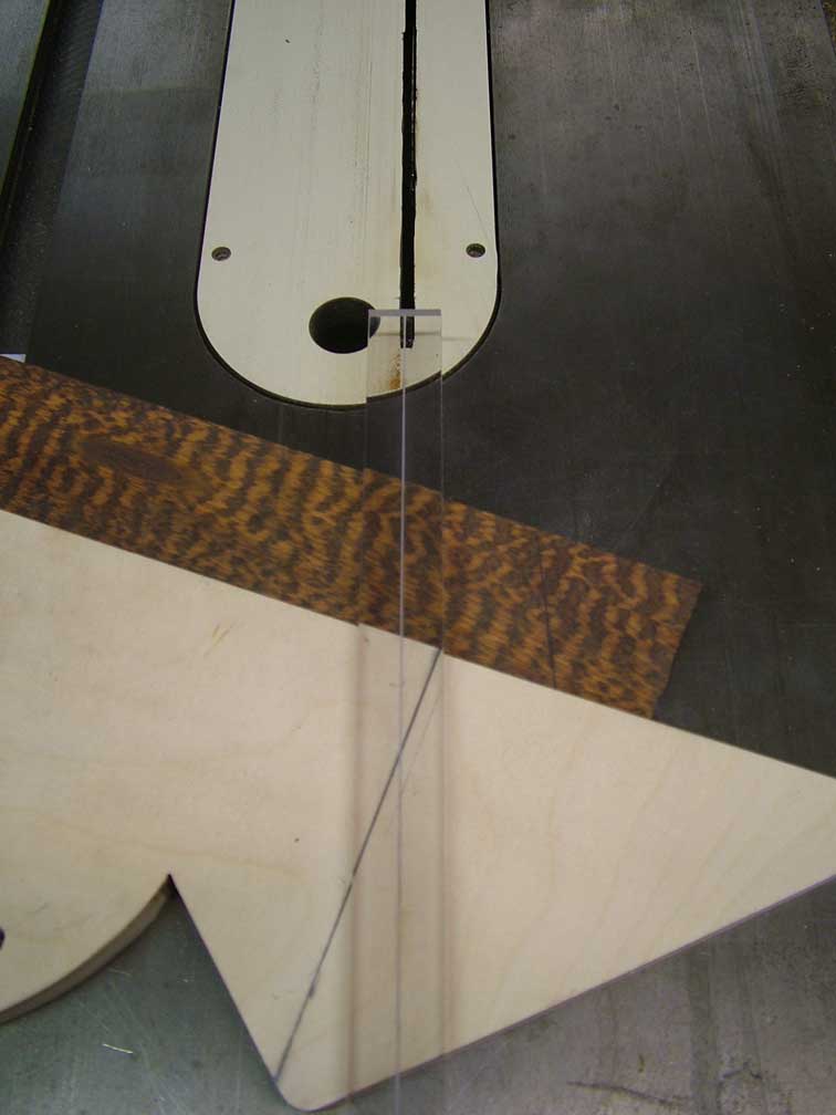

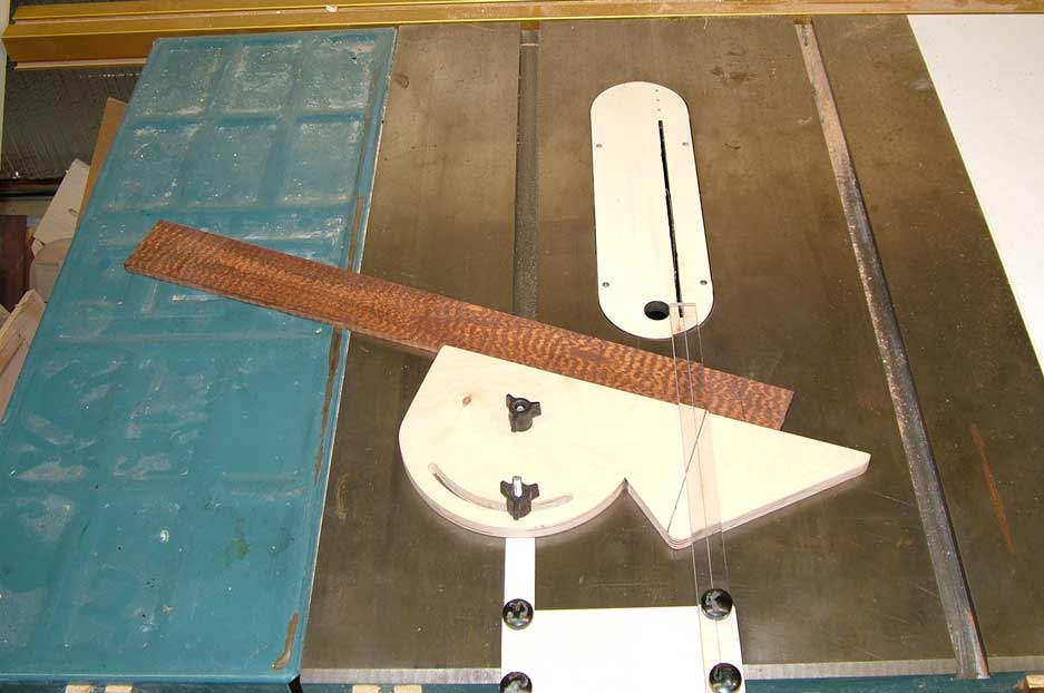

PostPosted: Fri Jul 07, 2006 5:55 am
Posts: 886
Marking and cutting the slots is the most critical piece, here's how I do it:
1. I taper my fingerboard to it's final shape, it's important to do this because as you move in and out the scale WILL change, also make sure you nut position is set and ready to go...
2. In my case I printout in 64th's the upper and lower scales.
3. I take a starret ruler and tape it to the fingerboard lining it up with the nut position, I don't want the ruler to move until I'm done.
4. using my list I double check each position and mark it with a sharp exact on the edge of the fingerboard (Cumpiano's method from his book is perfect for this). As I mark each one I mark it off the list, it's easy to get the numbers jumbled here, so I normally have my wife call them out to me as I work down the fingerboard.
5. Double check your marks, trust me on this one :)
6. Repeat steps 4 and 5 for the other side.
Now cutting the slots is somewhat of a challenge, I cut my first %100 by hand and it turned out great. But later I copied a jig from Harry Fleishman to cut the other, it looks like this:
The jig allows me to swing the fingerboard into position and the mark on the polycard (the index line if you will) is actually down against the fingerboard, this prevents paralax when lining up the fingerboard. One note here is that if you use this method you have to mark the backside of your fingerboard as this tool makes you place the face down on the tablesaw.
-Paul-
P.S. Here's a better picture:
Sprockett38905.6226157407
-Paul-
Patriot Guitars
